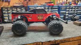

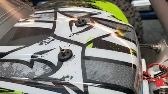

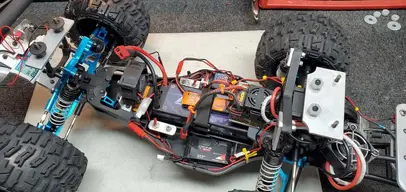

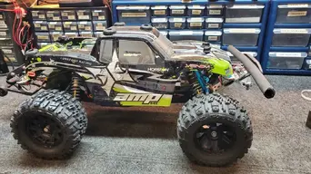

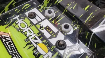

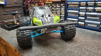

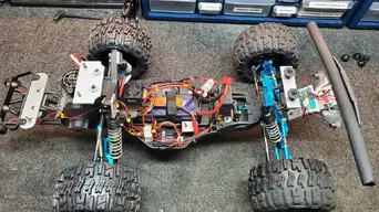

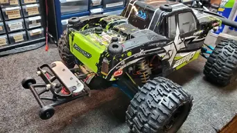

Lotty, there are a lot of upgrades you can do to the Amp Mt. Motor, ESC, batteries, tires, shocks, body lifts, lights, battery compartment mod for 3S batteries, micro switches, auxiliary batteries, modified body mounts, ect. The options are endless. Some upgrades I make myself.

Weave,
I love your custom mounts for the shocks and body. Had to engineer some brackets to raise the ass end of my body mounts and I'm so proud. Can't wait to paint this new proline Silverado body. The stock mt body I have is legit 80% duct tape now haha.
