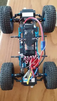

2017-07-01 14.04.22.jpg 2017-07-01 14.04.32.jpg 2017-07-01 14.05.15.jpg 2017-07-01 14.07.00.jpg
I found nylon spacers at Lowe's in the hardware bins, and put them on the rear shocks and right front leaving the left front alone. Also added 1.9 steel wheels and reversed the motor to reduce the torque on the left front.
Hope this helps!
And the wheel spacers to widen the stance! (Wider is Better)
