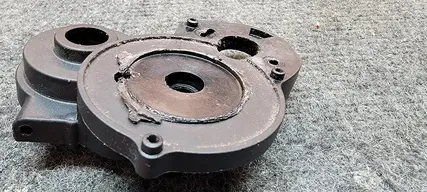

Remember, if upgrading to 3S, if you go with a Hot Racing Hard steel spur gear, be sure to also buy a hard steel pinion. You do not want to run a mild steel or plastic pinion with a hard steel spur. It will eat the pinion in a matter of time. Another advantage of using a metal spur gear is, it takes some of the heat away from the differential gearing inside the case. And one other note, when installing the spur gear, metal or plastic, be sure to place a shim over the spur shaft bearing or you will destroy the motor mount, as seen below. The clutch plates generate a lot of heat and, get very, very hot from drag (slightly lose clutch) and, from forward to reverse stopping. The photo below was a steel differential upgrade that one of my RC buddies did and, he forgot to replace the shim that was over the shaft bearing and the results are seen below. It was an easy fix, but most of the time was spent on cleaning things up. The motor mount was junk so I replaced it with a new one from my shop. Things are ok now, he's racing, bashing his Amp and god knows what else. So now, just waiting for the next fix, as that's what I do for the kids, and adults. Its called, Happy RC'ing.
If your going brushless on a 2wd ecx. Metal gear set is needed and also driveshafts. Mip 10130 fit with minor adjustments to your rear carriers. Others driveshafts fit to but the mip ones are highly unlikely to break. that will be the first thing to go if your gears don’t strip. Then the fact ecx wheels don’t hold brushless power all that well a hex mod is the easiest cheapest way to solve this. Hope that helps. The gool rc is hit and miss from what I can tell. Hobbywing has good reviews Of course customer service is the same so anything does go wrong you always know there’s someone to ring or email. I have good experience with racestar esc motor combos. The 60a brushless sensorless esc is good for 2s possibly a very low c rating 3s don’t throw a 70c 3s pack at it and expect it to handle it though it will melt I can tell you that maybe not straight away but in a few minutes it will melt itself. Saying this I am waiting for 120a racestar so can let you know how that goes. The 60a 3900kv racestar combo is a good one for sure just don’t over battery it keep it 2s and it runs a reasonable temperature reliable and quite a responsive esc. Also comes with a program card and few settings to play with punch ect of course low volt cut. The esc foot print is small to so fits most car including these ecx quite well
