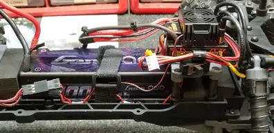

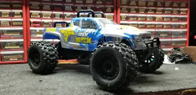

This is my Ruckus running on a 5700kv Castle motor and a 7000mAh 60C Gen Ace 3 cell battery with all metal gearing with 18 tooth pinion and 87 tooth spur.
I have no problem running this baby at 50 plus mph. Great truck!

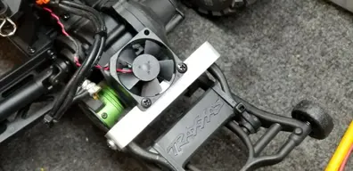

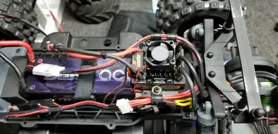

I've been doing a lot of testing and lab work on ECX AMP and Ruckus 2 wheel drive trucks as I like to take them to the limit. Don't get me wrong, they are great trucks. So I have my Ruckus hopped up with a 5700Kv Castle motor, 3s 7000 mAh 60C LiPo, all metal gearing and big tires. The truck runs great but after about 5 to 10 minutes the truck stops due to a hot ESC. It's doing what it is suppose to do (shutdown when over heated) but it is annoying and not good when racing. I've using the Castle ESC fan to cool the ESC but found it's not pushing enough air to cool the ESC so mounted a more powerful fan directly onto the ESC. Will test the truck tomorrow and see if that solves the problem.

Your problem is not - not enough airflow. it is too much motor. Or maybe too much voltage. What you need is a bigger motor can, with lower KV, and a bigger pinion. Plus probably a bigger ESC. I am guessing your combo is Sidewinder with the 3650 motor? Maybe step up to a 3660 SCT motor (ore even a 3675), and a 120a ESC. Get a bit lower KV and gear up. Keep your total RPM under 50k (you are above 60k now) (RPM = motor KV * Voltage).

Jerry, tomorrow im going to put a Castle 4800kv in the truck and see how it handles that motor. Thanks for the information. Everything's I've done doesn't seem to work. The 5700kv motor is running around 148 degrees. Question, if you gear up ( pinon) does that mean faster or slower?
If the motor is 150f, it is still safe. Motors are safe up to about 160, danger zone is around 180f. ESC limits are a bit lower.
To me, gear up means bigger pinion = faster top speed (assuming the motor can turn the gear)
