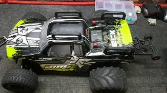

The best way to set tg e slipper and pinion is to put a piece o f pepper between the two, push the spur and pinion together and tighten the motor mount screws. Rotate the spur by hand and remove the paper strip. You will see the meshing marks of the two gears. The ECX Amp is a great truck and easy to upgrade. I myself have changed out the plastic spur to a steel spur as I was always burning up spurs and breaking C.d.s. (rear axles). Also you can save your body and help roll-overs by putting plastic drawer handles on the top and back as shown in the graphic, reinforced with aluminum strips on the underside, also great for picking up your car. This car shown has a top speed of 85 mph.

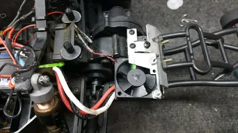

Your welcome, here are some pics of my ECX AMP Monster truck. I have a 4600K bruhless Castle motor, all metal transmission gearing and metal spur gear along with aluminum drive shafts. 2500.jpeg 2500.jpeg
