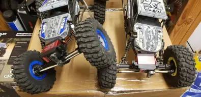

I lost steering on one of my Gen 2's. I could get a little steering from adjusting the trim and rate on the transmitter, but nothing from the steering wheel. My first thought was the servo went bad. I ordered two new ones (one for each) thinking that if one went out, the other wasn't far behind it. The one that wasn't working was the first to be replaced. Needless to say, I still don't have steering.
Any thoughts? Could it be a bad transmitter? A bad esc/Rx? (it does seem a little slower too)
Figured out I have a bad transmitter. Plugged the bind tool/key thing in and tested my other transmitter and bam, there was my steering. I'm going to contact Horizon Hobby tomorrow and see if they'll warranty it.
I'm not ready to change out the esc/ex on both yet.
