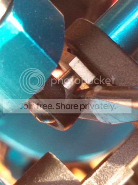

anyway then I send a picture so I avoid breaking everything !!!

I am attaching a photo so you can see how I would like to work to remove the shock absorber...
Insert the screwdriver and I leverage...
Can I proceed this way or I did not understand anything ???
Hello and thanks
Massimo
Proceed Sir. Remember that you can replace everything, so even if you have a misfortune it’s ok. And for tuning your shocks, you could have fun and change the shock oil then drive it. See how it does, then if the results were poor or worse performance change to a different weight oil and repeat the test drive. It’s more fun, and you learn more if you just try some different setups in my opinion. Or you could ask a member who has already figured out what works best for them. I’d describe how you drive, and on what terrain you run your truck on the most. Don’t worry, after your done with this project I bet you just might want to start a new project and get your truck a friend. Or two, or three.... lol Have fun !
looks like that is just a ball stud that the shock is mounted to
you could always just grab with needle nose pliers and twist while pulling
should pop right off
screw driver might work better though, less chance of scratching anything
