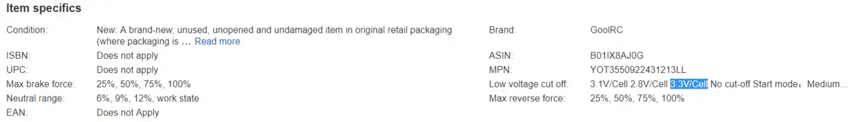

So, it's a different card than the picture? Because the picture of the card (in the auction) shows a 3.3V setting.
I apologize, I went off the listings, pictures and info.
You could use that to argue a refund, I don't know how badly you need the 3.3V setting, or the refund, but they did falsely advertise it with that setting.
True. Will just go with 3.1 and storage charge them after running
Just be careful if you use that. Running it below 3V can be damaging. So make sure you stop using that battery as soon as the LVC initiates. Since it likely will go after a large draw, that should leave your battery sitting a couple tenths higher. Then, as you said, storage charge back to 3.7-3.8V.
Nope - despite what the Ebay listing might say, the actual card is 3.1, 2.9, 2.7 and 0v
That's what my card has also
