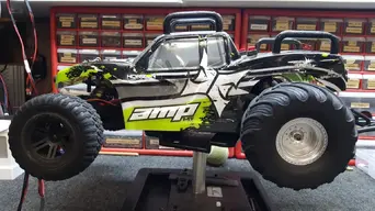

Hey guys, check out my pic below, this is what I've done to protect my body, .99 cent black plastic drawer handles mounted on the body, top and back with aluminium backing (1/16 x 1/2 x 3" long. Works great and 90 percent of the time the Amp will flip back on its wheels. Saves the body and great for picking up the truck.
It looks completely ridiculous, I love it.
Hahaha, that is just fantastic!!!
