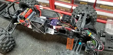

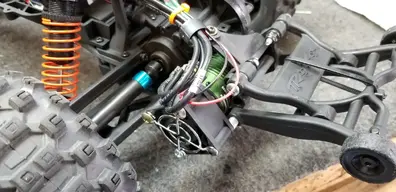

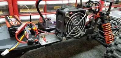

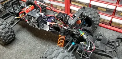

So here is what you can do too add fans if you wish to do so on your Ruckus. The bigger fan is 12 volt and runs on its own battery source, a 3S 11.1 volt 800 mAh plane $24. This fan keeps the battery cool and helps added cooling to the ESC. My Ruckus has 3 fans, the battery/ESC fan (which is switched), the ESC fan and the motor fan, all simple to install. The more cooling you have the better it is for the electrical components. The battery and motor fans are high velocity fans (pushs a lot of air 24 cfm) and are best suited for this type of application. The motor fan is a 5 volt fan and can be ran off the auxiliary input on the receiver.
We have a used electronics store here where I live HSC Electronics Supply and they carry all different type of hardware fans and electronics components, hardware, you name it they have it. If you choose to use these types of fans you will have to change the plug to the corresponding plug that's on the battery of your choice or to the plug type that's on the receiver. This is probably to much info for you and I am sorry. If you any help please don't hesitate to ask.
