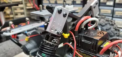

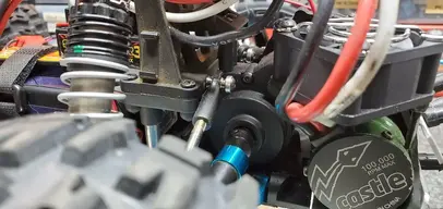

My Amp is upgraded with a Castle Combo brushless 4600 series, allaluminum suspension, Traxxas adjustable links, Hot Racing servo saver, big bore shocks, high velocity 5 volt fans, night running lights, 2.86 x4.87 Thrasher tires, Gen Ace 3S 7000 mAh battery and wheel hub extensions. The fans and lights run on their own separate batteries, 7.4 volt for the fans and 3.7 volt for the lights.

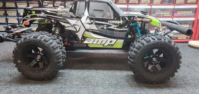

Thanks Jamkx, its a lot of fun. I have to admit I have the tooling to to make it easy to make these parts and upgrades. I just finished a friend's Amp yesterday and he's very happy with it. This is his Amp

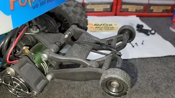

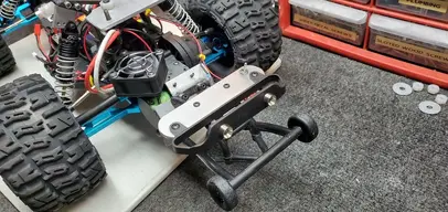

Hi I bought a 4300 kv 3650 motor ESC with programming card for $32 on EBay. It’s super fast on 3s and I need a wheelie bar. Any suggestions for a wheelie bar? I saw traxxas has one but I am not sure if it will work on the torment.

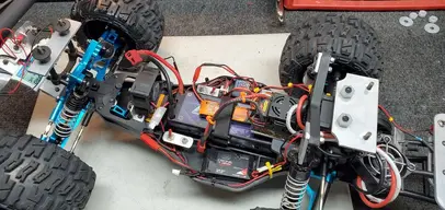

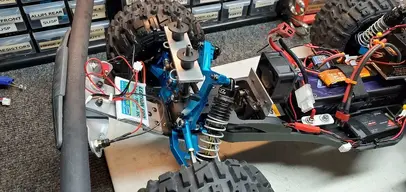

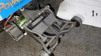

Jamkx, you can use a Traxxas or a DHK wheelie bar for your Torment. You will have to buy some 1/4 OD x 1/8th long x .150 bore (hole). If you don't want to go through all that work, you can use zip ties and attached the wheelie bar to the bumper.

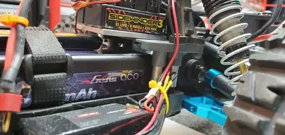

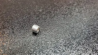

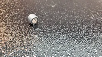

Awesome thanks for the info and the pics are very helpful. I just ordered the Traxxas wheelie bar. Where did you get those spacers? What are they? Did you buy them that size or did you cut them to length? Also I see you are running a cooling fan on the motor. I want to get a heat sink and fan but not sure how to fit it. There is not much space on my Torment for it to fit. How did you attach yours?
I brought the spacers at a surplus store, how every you can get them online, you just have search for them. There also known as stand- offs. The fan/ fans are high velocity fans, 7.4 volts .050 amps and run on their own separate 7.4 volt .850 mAh Drone battery. You can run off your transmitter if you want but you will be using the main battery power. That might be easier for you. You will have to wire the fan with the correct connector. Using an auxiliary battery you will have to install a micro toggle switch.
