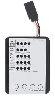

Is any one familiar with using these? It’s the GoolRC programming card. And if so, how do use it correctly? And what settings do you suggest? I got it for my ECX Amp MT. I upgraded the motor to a brushless system, GoolRC F540 4370KV brushless motor w/ 45A ESC.
Any suggestions or links would be appreciated. Thanks y’all DAAE5BB2-CA4A-4214-9380-E545B8DB8FA3.jpeg
The escs with the on/off switch plug the card in and turn the esc on to adjust the settings. The ones with the push button switch when turning on hold the button down while programming. Stock settings are are all the way to the left on the card. I change mine for most to 50 brake and 50 reverse leave the rest the same. The start mode (punch) is fine it's all personal preference don't like something change the setting.
Also for those that don't know no way to change the settings on the esc without a program card.
