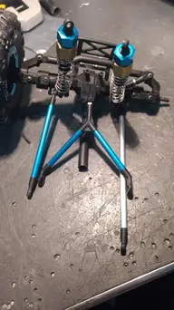

Well I finally made it over there and picked up a few things. Here are the parts cost me right at $20. I will post some pictures as I figure out how exactly I am going to do it.

What I was able to get done today. I am only stretching the rear. And from center at each end is 5" which makes it 10" from center to center on the wheels. I did put a Traxxas driveshaft in because the stock was too short. I also have a custom frame just hasn't been mounted yet and that is where I am mounting the shocks. Hopefully I will finish it tomorrow

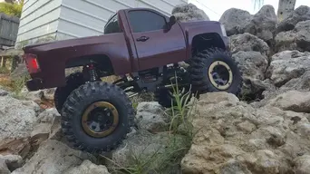

You can go either way. This is my redcat which is a clone of the ecx that i made a scale chassis for and shortened to 14th scale 17523411_1942219902680824_4631022024850715364_n.jpg
