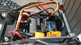

Next I installed new electronics starting with a Castle Creations Mamba Micro X esc.
Then I swapped the stock brushed motor for a Team Brood Racing brushless "Noisy Cricket" motor.
Added a Futaba receiver to go with my transmitter that runs all my rc's.
I am using a Venom 1300mAh 2S lipo for this rig. Fits perfectly under the hood.
I cut a notch in the dash for the wires to come through & a small notch for the wires in the front of the battery tray.
Nice & snug!
Nice & snug!
