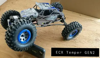

Just thought I'd share some info on my gen 1 incase its useful. I got one of the $100 barrage doomday's a while back. I used the Barrage transmission, driveshafts, axles, and links. Running my Losi 1/18 crawler motor on the barrage transmission. The barrage trans drops right into the stock gen 1 temper skid plate/chassis, just took a little grinding of the barrage motor mount edge to fit between the chassis plates. Works awesome. My wheel base is at 10.5"
How's it drive like that? I imagine less tendency to flip backwards on the steep stuff
Its a completely different truck now, handles great, I just need to play around with shock oil. Doesn't help when its so cold here in WI, shock oil gets thick, even though my indoor course is in a heated shed. I went to a 4 link setup a year ago and I thought that was a game changer, but this barrage running gear is the cats-ass.

I just finished my build!
Installed NEW;
Onyx 40amp brushed crawler ESC
2S lipo
Radiolink RC4GS radio and receiver
Light kit
Brass hexes
Still running the stock servo.... Soon to be gone. Not strong enough to move the upgraded wheels anymore.
I will have my build video, and running video after this weekend uploaded to my You Tube channel.
Enjoy the pic!
