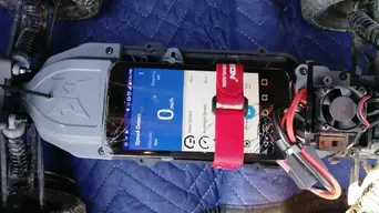

If you are going loosen the clutch a half turn or more I recommend you go to a steel spur gear as the the plastic spur will get hot from slippage and melt. I've been through a few plastic spur gears and finally went to a metal spur and have no more problems . I wouldn't recommend loosening the clutch with a plastic spur. The two clutch plates absorb the heat from the slippage of the clutch and get so hot you can't even touch them when taken apart. At that point the heat has nowhere to go but to the transmission shaft and bearing area of the tranny and motor mount. At that state the transmission shaft bearing has absorbed the heat and melted the bearing seat which now the whole motor mount will have to be replaced. A metal spur will absorb the heat and transfer some of that heat through the pinion and through the motor.
Both my trucks, AMP and Torment have Castle motors and 7200mAh 60C batteries steel drive shafts which also absorbs some of the heat from the metal spur through the tranny gears (Yes I have all metal transmission gears also). We have fourteen 1/10 scale rc trucks between my son and I, some two wheel some four wheel and nine of them are brushless.
So, getting to your wheelie question, I would reprogram your ESC for less torque instead of loosening the clutch (loosening the clutch will ware it out faster also) if you don't go to a metal spur gear. If you have a brushless motor read the directions for seating up the ESC (electronic speed control).2422.jpeg
