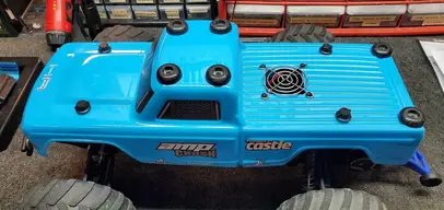

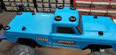

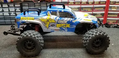

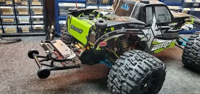

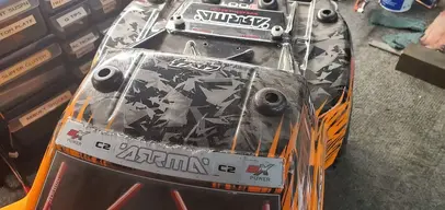

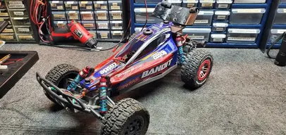

EcButler, if your looking to save the body the the easiest way to do it, is to add plastic drawer handles or furniture buttons. Furniture buttons are the easiest to install, doesn't increase body height. I have used both, and in my experiences the buttons are the best and easiest to attach. Don't forget to use 1/16×1/2 inch aluminum flat bar on the back-side of the body for strength. Don't mount directly to the body.
