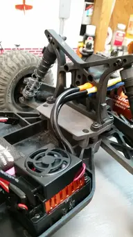

Another reason I mounted the esc on the drivers side was the motor wires seem to be rather short, didn't seem like it would reach the opposite side. My motor wires routed nicely through a opening in the shock tower.
