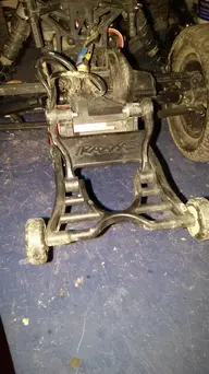

I put the Traxxas one, with some modifications, on my Ruckus.Do they make a wheelie bar for a ruckus Monster truck. Or how can i install one on mines
What kind of modification need to be done do you have any pictures of how you did it?I put the Traxxas one, with some modifications, on my Ruckus.
I bought some tiny nylon washer nuts and bolts and took part of the wheelie bar off entirely. If you get the wheelie bar and look at the pictures, you'll see what I did. I think I had to cut part of it. And you have to remove the rear bumper, obviously.What kind of modification need to be done do you have any pictures of how you did it?
Oh i see but i have the low visibility wheelie bar from rpm ..I bought some tiny nylon washer nuts and bolts and took part of the wheelie bar off entirely. If you get the wheelie bar and look at the pictures, you'll see what I did. I think I had to cut part of it. And you have to remove the rear bumper, obviously.
View attachment 1095 View attachment 1096 View attachment 1097 View attachment 1098
So how is the durability and has it ever came off or loose after some bashing?Oh i see but i have the low visibility wheelie bar from rpm ..
So u just installed the wheelie bar only right? No other kinds of mounting kits or parts from traxxas thanksSo how is the durability and has it ever came off or loose after some bashing?
I just installed the wheelie bar, not other kinds of mounting kits needed in my case other than the screws and nuts from the local hardware store. But I do remember removing part of the stock Traxxas wheelie bar to mount it. The prongs that come off the back that are supposed to mount it to the vehicle were removed in order to attach it to the Ruckus. If you look at a picture of the part on a website you'll see the prongs.So u just installed the wheelie bar only right? No other kinds of mounting kits or parts from traxxas thanks
Any idea what part number it is ? I heard there are different versions one with small and one with big wheelsI just installed the wheelie bar, not other kinds of mounting kits needed in my case other than the screws and nuts from the local hardware store. But I do remember removing part of the stock Traxxas wheelie bar to mount it. The prongs that come off the back that are supposed to mount it to the vehicle were removed in order to attach it to the Ruckus. If you look at a picture of the part on a website you'll see the prongs.

Its Traxxas 3678...I picked one up off ebay for $11. No idea why ECX doesn't just make one that fits.Any idea what part number it is ? I heard there are different versions one with small and one with big wheels
