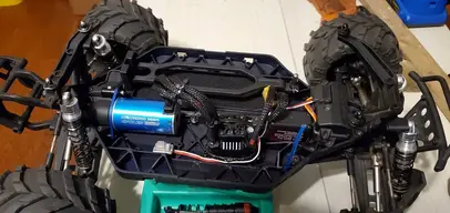

I believe we (my son James and I) have found the functional limit of our 2WD Ruckus. Build thread here:
https://www.ecxforum.com/threads/hi-from-nj.3270/
It had just become too powerful, too much grip, too short wheelbase for what we were doing with it. It was a wheelie machine that no amount of front weight or turning down the tx or ESC was helping with. Finally James put it into a metal guard rail at ~50kph. I was looking at more metal components in the front end and a wheelie bar from a Traxxas. The real solution was put a weaker motor in it, put crappier tires on it, or put a weak battery in it, none of which I liked. The idea of going 4WD had always been in the back of my head, so before dropping the coin on the upgrades I did some research. I was assuming we would be jumping over to Traxxas for parts availability, but the heads up comparisons of the Ruckus and the Stampede, I was surprised to see the Ruckus getting better reviews (from the chassis perspective, nothing else we leave stock). As an added benefit, that would allow my son to keep his beloved Paw Patrol Ruckus body (painted by my dad the slot car guru). But 4WD 1/10 Ruckus are HARD to find.

It was a little dirty when we first got it. Cleaned the battery hold down when I swapped in a battery you can see the difference. Put in the spektrum receiver I had from the 2wd pile of OEM parts and used the radio as well. Made a quick bind plug for it. Swapped out the servo for the amazon 25kg units we like. Someone ran this hard and put it away wet. I have to use the stock horn/servo saver for now because the aluminum horn that comes with the new servo is too long - I ordered what I think will be the correct one.
Tried to do a really good cleaning of the chassis. I still need to disassemble the front and rear suspension but it's 90% better. Put in a 4300kw motor I had sitting around because the stock one is making some odd noises and feels very crunchy - moreso than just the feeling of the magnets cogging. Using our stock 2wd body for now for testing. Prolines are borrowed from our 2wd ruckus - didn't even bother to run it on the rock hard amazon sct wheels this came with. These badlands are out of this world good.
Front end got a little light/floaty on 3s, but nothing like the uncontrollable wheelie monster on the 2wd. Probably move this motor and 2s over to that and put the big hobbywing esc/motor on this. ordered up a bunch of little parts we want to swap.

So far just cleaning it and running it. Seems to have taken a few good whacks already. In general the parts are significantly more robust than the 2WD. For all intents and purposes, they are two entirely different trucks that just share the same name and the body. Literally nothing between them is interchangeable down to the smallest part like wheel hexes.
We are running into a lot of parts UNavailability, and what I believe is a bad ESC. 10BL120 on order.
Like my GPS mount? LOL. Normally I wouldn't be so quick to run one of the most expensive single pieces of the RC out front like that, but view my previous pics of 50kph hit it took in that case and you'll see why I'm ok with it. Cheap front end weight. I should probably paint a part of it some really bright color so if I lose it in the lawn...
Receiver came in so we can use the controller we prefer. Waiting on the bracket for it. No more losing body pins, installed Du-Bro retainers. I recommend 4mm pilot hole, then ream out slowly until a tight fit.
Installed 25T servo horn. Had to remove the two servo bracket screws from the bottom of the chassis because the stock steering saver is so big you need to pull the whole servo out of the RC to get it off. New horn goes on and off without having to do that. The servo came with a steering horn originally that was too long, it made the steering arm hit the chassis. I measured the stock one and it was the same as the middle hole on this one (16mm). Hot-Racing isn't carrying anything anymore, so all parts are basically going to have to be this trial and error process. Here's the link
https://www.amazon.com/gp/product/B07PQMB9KL/ref=ppx_yo_dt_b_asin_title_o05_s00?ie=UTF8&psc=1
I cheat - I put the horn on guesstimate with no bolt, then turn on the radio and RC. The steering self centers, I make sure the trim on the radio is zero, then I pull the horn off and install it at 12 o'clock. Run it lock to lock to test, orange loctite.
Waiting on more parts to arrive before we run it again (chiefly the ESC but also little things like wheel hexes and bearing kit). Wheel hexes are also discontinued by Hot Racing, stock ones have a lot of wear at the pin. I think I may have sourced some that will work after I pulled the front steering hubs off and took some measurements. Trying to chase down aftermarket aluminum front steering hubs, Hot Racing confirmed they haven't produced parts for 1/10 4wd in about 3 years they've just been selling off old stock and when it's gone it's gone. Same we ran into on our 2wd. Some "lifetime warranty." Broke 2 of their parts, wasn't able to warranty either.
