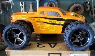

This post, may be putting the cart before the horse, but I couldn't help myself. Nothing has been done yet, just appearance for pictures sake.
SNEAK PEAK!!! Yes, I know the tread is backwards. ?
Love the tires?, it works better with the body than the originals
Thanks for the compliments @BkRc4! I think it will turn out just fine.
The new wheels and tires are way better than the stock ones, the stock ones looks like they used a tube of super glue on each wheel, inside and out. And they are hard as heck, way harder than the stock Torment tires.
The new tires are fairly soft, which may mean they will burn up quick.
