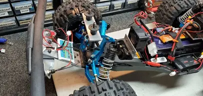

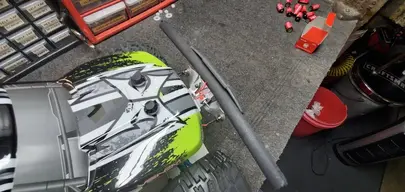

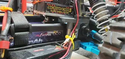

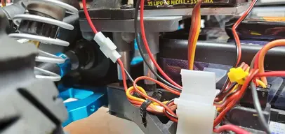

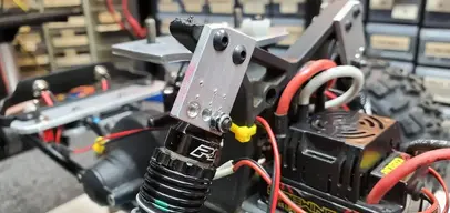

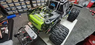

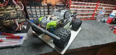

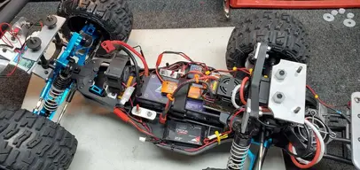

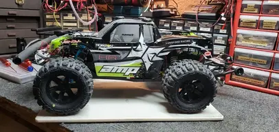

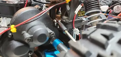

Witiko6, you can go 2S LiPo 7.4 5000 mAh to 7000 mAh with the stock brushed motor except you will have to change ESC (electronic speed control). If you go to a 3S you will have to raise the rear battery compartment as the battery wont fit under the platform. Depending on what version Amp you have, the older Amps, the rear battery compartment is part of the rear/shock suspension (which is what I have) and requires some ingenuity to raise. The new models have a redesigned battery platform which is no longer part of the rear suspension.
