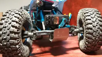

Here is the tire and wheel combo I have. And if some one can identify them I would like to put them on something else
