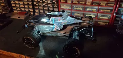

LephTurn, I used that setup on two of my semi clear bodies. I routed all the wires/leds thru and on the chassis cause of all the wiring length. You want to be able to remove the body without having to unplug wiring. Below are the two semi clear RC's I did that too. The blue truck is with head lights and back light all wired to the front bumper and back wheelie bar.
Wow that looks amazing! Great work, that is a piece of art. The second one is what I was thinking, I hadn’t considered anything like what you did with the first one.
Makes sense to route and mount it all to the chassis. I may look at mounting something to the body for a shelf queen/show off body where I won’t mind plugging and unplugging.
