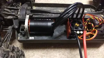

What motor ESC combos do you have currently. I crammed the cc sidewinder 8th combo in my 2wd 1/10th ruckus. Its a blast! Tight fit though.
Have either of you had to do any upgrading of driveline components to support those larger scale combos?
Steel Spur from Hot Racing. So far, both spur and pinion show no signs of excess wear. My big weak point is the wheel and hex. However, my PL Badlands 1/8th should be in Friday and I can install them along with the Hot Racing 17mm adapters for Traxxas.
We shall see how things hold up. Lol.
A side note, I lost the O-rings for the drive shaft and that took a crap. Oops.
