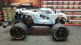

Hello all. First time poster. So I picked up an ecx amp a 3-4 months ago for my 10 year old daughter and she loves it and gotta say so do I. So a few things have been done. Metal tranny gears with the ruckus brushed setup right now(have a ruckus that I converted to a brushless castle setup) and currently have a goolrc 3500kv 60amp brushless combo coming. I added front and rear traxxas adjustable camber arms (i think that's what there called) and also installed the rear end of the ruckus in order to install a traxxas wheelie bar I picked up and changed the servo to a power Hd 20kg and changed the rear shock tower to fit the circuit body she just loves the look more and I do as well. So now I am curious about tires at my local shop I noticed they have traxxas rustler front and rear premounted tires and was wondering if these would fit. I was also wondering what are my options for adjustable steering arms? Thanks for the help. Heres a few pics of the truck.

The tires will fit as long as they are the same hex size. The turnbuckle you will need are HRAECT5406 from Hot Racing.
