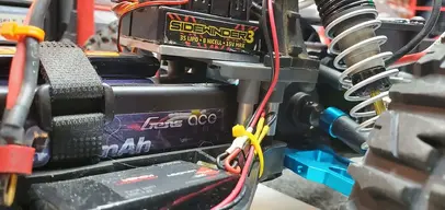

They aren’t much faster than a fully charged NiMH they just dont drop off as much during a run and they last much longer. I have a 7,000 mAh 2S 50C that was going 40 minutes plus on my son‘s sock brushed Amp MT. Running with a voltage alarm on the balance lead of course.I'm learning all this as I go, but I just did all your research for you. I talked to a few people and bought two Lipo batteries that I actually chose not to use (my NiMh batteries are fast enough for my son and I). I have them for sale here on the site, but these are the ones I was recommended to use with my ECX AMP https://www.kingcobraofflorida.com/products/onxp50002s30h3
I think the main thing is to not go over 2S, 7.4v and make sure the connector is EC3.
