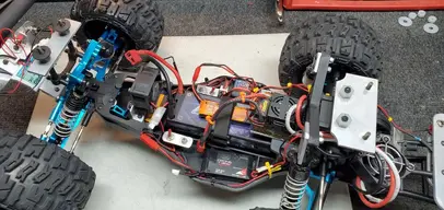

Hi guys, just want to say that I have the older version of the Amp were the battery compartment is part of the rear suspension. I want to say the is one great truck to upgrade. The possibilities are endless. Check it out.
