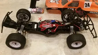

So yah, I told myself that this was going to be my fun backyard basher... Now I have just finished ordering the Xtreme Racing's LCG conversion along with all the parts necessary to finish the build properly.
Parts list:
ECX Torment Brushed K&N Edition *
RPM servo saver delete *
homemade slipper eliminator *
homemade rear diff mod to seal rear diff and 10k cst diff oil *
Hot Racing's CVD kit *
ECX aluminum threaded shock set
Screwz TLR 22SCT stainless steel screw kit
Xtreme Racing's G-10 frame extension
Xtreme Racing's G-10 battery strap
ECX Circuit Chassis, top plate, and suspension mount set
Traxxas turnbuckles (camber and toe) *
Team Associated #40 shock oil
Team Associated white SCT wheels *
JConcepts Dirt Webs tires, front and rear *
(parts listed with * have already been installed)
So much for a backyard brawler. Now she's going to be more of a track princess! ;)
I will post pictures as the parts roll in and I get them installed.
(this is how it sits right now next to my B5M factory lite)
