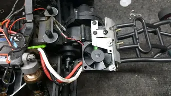

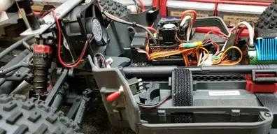

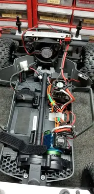

Dan, I run a 4600kv Castle sensored motor also but I don't have to wait for a motor or ESC cool down. My truck has four fans, one which is 12 volt 2x2 and pushes 24.0 cfm of air. I ran my truck for 20 minutes full bore on the street and measured the temp of the motor and ESC the run with a laser thermometer and the motor was 85 degrees and ESC was 82. The big fan runs on it own 3cell air20180110_171524.jpg 20180110_154821.jpg 20180110_190404.jpg plane battery.

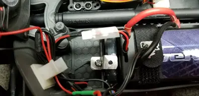

cc4600a.JPG cc4600b.JPG cc4600c.JPG *I wish I could fit a heatsink/fan for the motor can.
**You can see in these pictures how 3/4 of the motor can is shrouded in plastic.
(I might be able to remove the plastic top bumper/transmission brace and fab something to mount a fan blowing downwards)
This is a Castle Creations 4 pole 4106-4600kv with mambax esc. Using the Castle tuning software, it specifically states, NOT to adjust the timing, to use the sensored pre-programmed timing curve. *It states that damage will occur along with excessive heat when using "cheat mode" for adjusting the timing with this 4 pole motor....

Dan, you won't melt the Gray skid plate on your Amp, Toement or Ruckus the melting point on that skid plate is 210 degrees.

Thanx for sharing your pictures of the custom fan mount that you did on yours.(It gets me excited to be creative)
I Wasn't concerned about the plastic melting, I was describing how ineffective any natural air flow is with the way its currently configured. (currently very little of the motor can is open to air)
Yes, you are right about very little open air space for the motor. I'm always experimenting with cooling. I've had fans on top, on the side, I even had a fan mounted on the clutch cover sucking all the hot air out of the housing. That worked great, it stoped me from melting my spur gear all the time. I don't use that setup anymore as I went to all hard steel gearing.
It's really fun making design changes to trucks/cars. Most of my vehicles have three fans and some four, which run on there own separate 3S battery. So yea, a little ingenuity, common sence and quality workmanship makes it a lot of fun.
