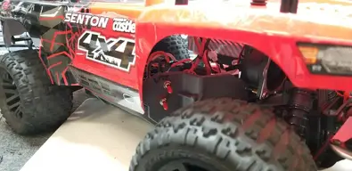

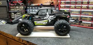

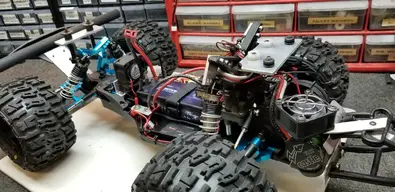

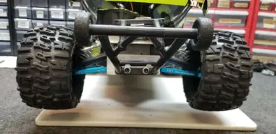

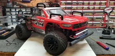

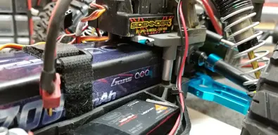

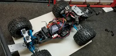

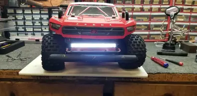

RcTaT, I changed to hard steel spur an pinion gears on my AMP, in fact I changed all my Rc's to hard steel gearing, I was going through plastic spurs at least one a week. Now all my Rc's are brushless motors and 3S 7000 mAh batteries and do about 70 mph and wheelies, so they go through a lot of abuse. Most of our racing is done on asphalt (and sometimes dirt). Metal gearing is a little more noisier then plastic gearing but putting some good quality grease on the gears will quite them down some what. I have not had any more problems with spurs or pinions anymore. I want to say that if you go to a hard steel spur, make sure you go with a hard steel pinion. If you match hard steel with soft steel (low carbon or mild steel) you will eat the mild steel. This all depends on what you want to do with your RC's, if you are going to stay stock then plastic is fine. In the RC world we do all kinds of modifications to our vehicles, some minor, some drastic. Which every way you go, just have fun and experiment, that's why it's called a hobby. Here are some mods I did on my AMP and Sent on.
