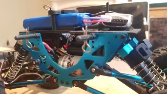

Hi Stamatis, I bought my Temper second hand a couple of years ago but never used it much as the TT was ridiculous. I found your post and I've used 7mm cable ties to limit the suspension travel and it's a different machine altogether. Also turned around the battery tray and put the ESC / receiver underneath. Soo much better. Need to sort the tyres next.
