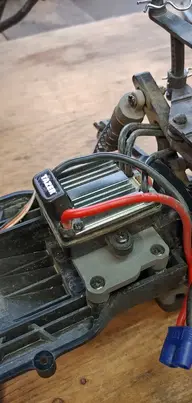

Well.... Ive bought all the parts.
Wondering if i need balljoint type screws for the traxxas steering linkage and turnbuckles to connect to?
Also .... Still wondering if this tazer esc can handle 3s? If not ...what should I upgrade to?
