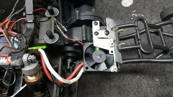

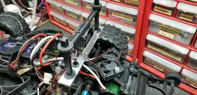

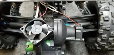

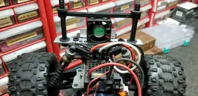

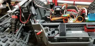

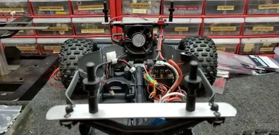

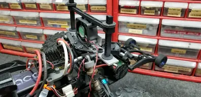

If you go to all hardened steel gearing, a brushless motor (4600KV), 3S Lipo battery, bigger tires (you may have to do a body lift), metal CV'S and good cooling (my vehicles have 3 to 4 fans, some 5volt some 12volt) you should be able to reach 65 plus mph, depending on your gearing and motor size (kv). Again, cooling is VERY important as you will create more heat. You can get rid of that heat with the proper fanning (high CFM's air flow). Use your imagination and remember, the small rc fans don't push a lot of air and they will only operate on 5volts. Using a small 12volt computer fan will push much more air and can use it own small 3S 11.1volt plane battery and a micro switch to turn it on (Radio Shack or Frys Electronics). All you have to do scope everything out and wire it up. It is is hobby after all and modifying and making better is what its all about. I have seen some great modified projects by young kid and adults that blows my mind.20180123_190817.jpg 20180123_190743.jpg 20180123_190619.jpg 20180110_171524.jpg 20180110_154802.jpg 2499.jpeg

I had that motor in my Axial Warith, its a great motor for a Rock Crawler. I traded in my Crawler at my hobby shop and received $289 trade in for whatever I wanted. I'm not in to rock crawling, more into speed. My crawling was to slow for me even with a 2S 5000mAh battery. Your motor may well handle a 3S LiPo battery but your ESC may not. I would recommend a 60 amp ESC and go for it. If you don't smoke the motor, it's definitely going to get super hot and won't last to long. All my vehicles are all brushless and some have major cooling. One truck has 5 fans, which is pushing 38.0 CFM of air. (see pictures).
20180125_003238.jpg 20180123_190619.jpg 20180125_171835.jpg 20180125_002805.jpg 20180125_002755.jpg 20180125_184221.jpg
