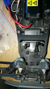

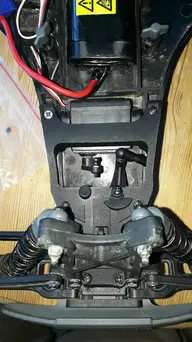

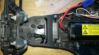

Ok, I bought a new servo saver kit and bottom plate (as I couldn't get the silver pin out of the bottom one). I have just spent the last 2 hours installing it all and still the same problem. The photos below show how far each way the steering arm goes from one side to the other (with the control unit adjustment just set to the middle).
Do you think I need a new servo motor?
Also, the other arm (from the servo saver end) seems very close to the servo itself - is that right?
Thanks so much for the help - I really need to get the car fixed in time for the weekend, so any help would be REALLY appreciated!

Did you buy a stock replacement servo saver kit, or did you buy the RPM servo saver eliminator kit?
plus your linkage isn't hooked up, and yes it is that close, you may need to adjust it a bit. But if you didn't mess with the linkage then it should be close.
Plus, your servo horn doesn't look like it's all the way on the servo gear? Also did you check your dual steering rate adjustment on your transmitter, is it turned all the way up?

No no, your fine on the servo saver question, I was just clarifying it for me.
The servo horn, is the arm that is attached to the servo gear, it's the arm the linkage attaches too.
"Typically" the servo's just quit, but they could stop working correctly and not have as much throw, but again typically they just stop working.
