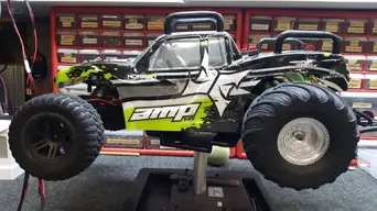

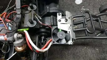

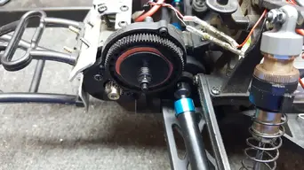

BriaN, depending on what you want to do with your AMP will establish how you will set it up. I have the same truck and was melting spur gears at least once a week. I did everything from tightening the slipper to backing off 1 1/4 to 1 1/2 turns, didn't help. This was with the stock motor and my Castle brushless motor. I finely got smart and upgraded to hard steel spur and pinion. Problem solved! I also went to all steel differential gears and CV's. After further investigating, the heat created by the slipper clutch is now transferred to hard steel spur and out to the motor and air cooled unless you have a fan on your motor, which I highly recommend. By the way out of all my 24 RC's the AMP is my most favorite and has been clocked at 60 plus. It's a great truck when upgraded and easy to work on. Myself I like speed so I use Gen Ace 3S 7000 mAh 60/150C LiPo's in all my RC's. It took about two and half years to get where I'm at now and its worth it, and I'm 74 years old and still playing.

Okay, thank you for all the information. I really like the look of your amp, and how you mounted the fan on your motor. But, from my video, what do you think that sound is? Someone said it was just the rattling of the bearings
Brian, I agree with KyleRC, brushless does have a different sound. A better demonstration of your video would be to give the truck some resistance instead of holding the rear in the air. Other then that I would recommend installing a metal differential as you may have a chipped tooth in the differential. One more thing I would do is to check the slipper clutch to make sure the pressure plates have not melted the motor housing as they get very hot.
