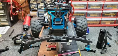

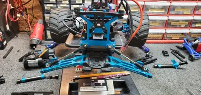

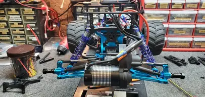

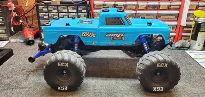

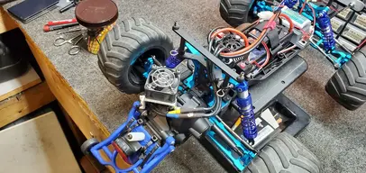

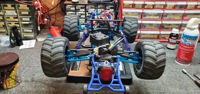

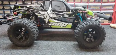

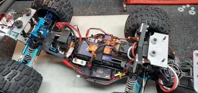

I have two Amp Crushs, one blue and the orange one. Both have been upgraded from suspension, to night running, to brushless. I have recently started using the Hobbywing Easy Run 4000kv brushess motors and have absolutely no problems. Both trucks run on Gen Ace 3S 7000 mAh (7 amps) batteries. I also have the first generation ECX Amp which is also upgraded as above. These trucks are awesome when they are upgraded. Out of the 36 rc's that i have they are my favorite. Here are some pictures of my blue Crush and my Amp. Happy Rc'ing to you and use your imagination and ideas.

View attachment 6471View attachment 6472View attachment 6473View attachment 6474View attachment 6476View attachment 6477View attachment 6478View attachment 6480View attachment 6481View attachment 6482
Wow, amazing work.
What did you make those body mounts out of? I need to fabricate something.
What are you using for camber links in the rear? The cheap Banggood ones I bought got super sloppy very quickly.
The body mounts are Proline Extended body mount thumb nuts or sometimes called thumb washer. What i do if possible is flatten the top of the body post and drill for a M4 set screw, then screw the set screw into the drilled hole about half the length of the set screw that comes with the kit. If you have an M4 tap its better to tap the hole just enough to start the set screw, after that the set screw will make its own threads in the plastic/nylon. Its a lot faster removing the body with the thumb screws.
Proline makes body lift kits. The camber links i use are Traxxas steel links, do not use aluminum as they will bend. I usually keep different sizes of links on hand as there not that expensive.
