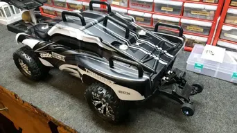

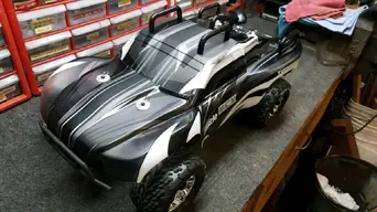

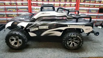

Below is my knew Traxxas body that I modified to fit my Torment Chassis with extended body mounts, and also added the bars on the body. It definitely saves the body and 90% of the time when it rolls or flips, it lands back on it's wheels.
Good looking truck man! I'm using Flouereon 6200 40c, Peak Racing 5000 45c, and been running a SMC 7200 90c in my Tekno sct 410.3 4x4. It has a hobbywing xr8 4300 combo in it. Total beast mode, but man is it fun to race.
