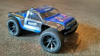

Yesterday i finished the rebuild and my son was so happy to see this little car. It is now a Monster SCT and no longer a ruckus. Self painted dromida body, medialpro tires and some other things.

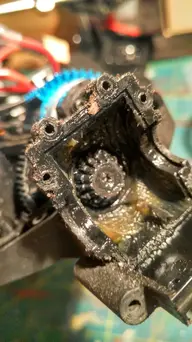

It was time to have a test drive after the complete rebuild. But i had only fun for 20 minutes. After 20 minutes on the street (no offroad) i heard some unwanted noise. My hope was that i forgot to fix the screw of the motor and the noise came from the main gear. I was surprised, it was not the main gear , pinion, ball diff, dogbone, axle or any other parts which i have raplaced. It was the original plastic gear of the diff out towwards to the drive shaft.
But a picture is better than words.
No fun any more with this nice truck. My son will not be happy. "Oh poop".
Any ideas how to repair this, without buying a complete diff from ECX?
I'm so frustrated at the moment. It takes about 2 weeks to rebuild the car and now this happens.
:( aww that is what happened to mine about a month ago. Are you on the stock motor? My slipper was wrenched tight and with a brushless motor the truck got wedged under a log and my son was hard on the gas while it was stuck. I don't know of a way to fix that without a new diff but I do have an idea to be able to use a different gear there. I just haven't had time to mess with it.

Well I ordered the parts and wow...the answer has been there all along. Thanks for posting the parts #'s I still can't believe I took the ruckus off the shelf. I took some quick pics just in case anyone else is in disbelief like I was. Full metal drivetrain, finally.
And I really tore up this last diff. I have never done this much damage.
