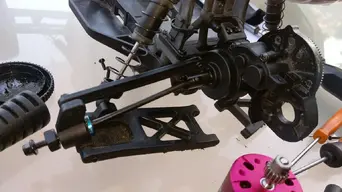

Today I found a little time to finally mount the metal gearsets...

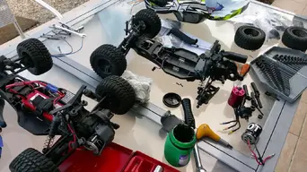

The garage :

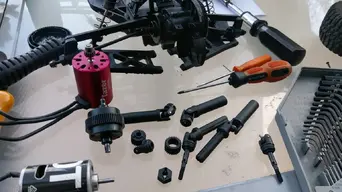

the gearset mounted. I used graphite grease on them...
Then I mounted the steel drive shafts...
The removed parts :

Nice reading your upgrades man. I used traxxas driveshafts, but let me know how the steel ones hold up. They are Hot Racing right?
Yeah, they look like the SECT288. I have two extra pair of you're interested...
Mine have been solid so far in both the Ruckus and AMP DB.
Sorry for late reply, holliday tima ya know...Yes, they are Hot Racing parts.
Now for the good news, I finally got my packages that were blocked in customs :
Time to rock n' roll !
