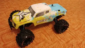

I use 2s 45c lipos. Here is a picture of the car
I would say for 2s and mod free installation with no binding get the Hotracing SECT288X06.
